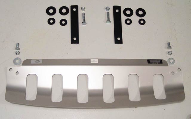

In this first pic you will see all the parts I used. for the bolts that go through the tow hooks, I used 1/2" x 2" bolts, along with the standard 1/2" washers. Since the 1/2" washers are too small and would pull through the tow hook, I placed a larger washer on either side of the hook. I painted all the washers for the tow hook end before I installed.
The metal strip was about 1 1/2" wide and about 1/4" thick. I got it at Home Depot in a four foot section. The crappy part was cutting it with a hack saw. I cut it to 8" sections and drilled 1/2" holes.
The bolts are 1/2" by 1 1/2" but I ended up cuting them down to 1" so there wouldn't be any sticking out the top.

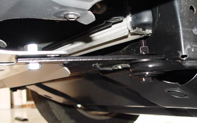

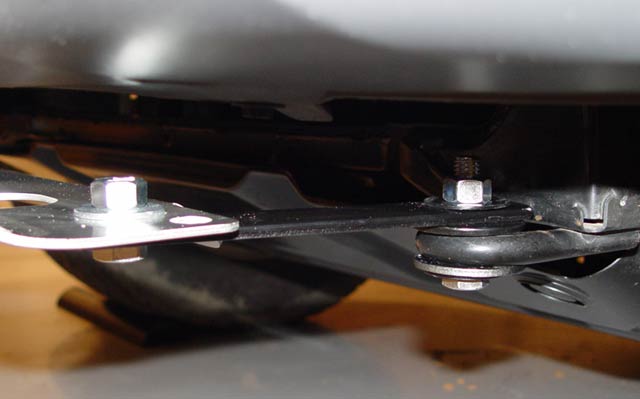

Here is the bracket installed.
On the tow hook end (from the bottom going up) I put one of the 1/2" washers on the bolt then on of the large washers, then pushed it through the hook. On the top of the hook, I put the other large washer, the bracket, another 1/2" washer, then the nut.
On the skid plate end of the bracket, I put the bracket under the skid plate, since you can't really se the underside. Then just put the (cut-down) bolt through the bracket and skid plate(from the underside) then the 1/2" washer and the the nut.

After I got it all tightened up, I sprayed the bolts on the hook end so they didn't stand out. I didn't paint the nuts or bolts on the skid plate end since all that is silver.
With the brackets I made there are several ways to install. You can put the brackets on the bottom of the tow hook if you want more space. There are also to holes on each end of the skid plate, so depending on which holes you use, i will push it out or pull it in closer. (I used the two most inside holes.

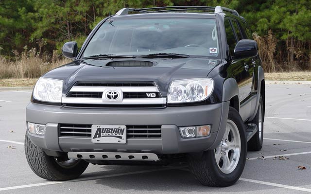

Of course I saved the best for last.....:laugh:
Keep in mind, this is just for looks. Since I rarely go off-road, that is all I wanted. I feel quite certain it would be ripped to shreds on any kind of rocks..:laugh:
Also, keep in mind I have no welding stuff, and just made due with what I had. I am sure some of you guys that have welders and such could make much better stuff, but I still had a good time.

I like it. Great engineering too! Fairly easy with parts the masses can deal with.
Great look which also matches the wheels nicely.
Any kind of vibration? Wind buffeting?

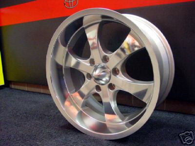

Are those 20" Enkeis you have. They look really good. I've been thinking of getting these. 4 for $1400 What do you think?

Greenhorne, I haven't noticed any vibration at all. The steel strips are thick enough to keep it steady. Belive me, I messed with it after I installed it and it is pretty firm.
FirstToyz, it is a little decieving but the brackets are a slight angle sinne I used the inside holes on the skid plate. Not to mention I tightened the crap out of the bolts, so I will be surpised if it moves.
Biff, mine are 18" Enkei's. Those that you are showing are really sweet. I saw a Tundra at the dealership with those on it and thought they looked great. I would love to see what they look like on a 4Runner.
