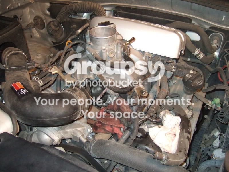

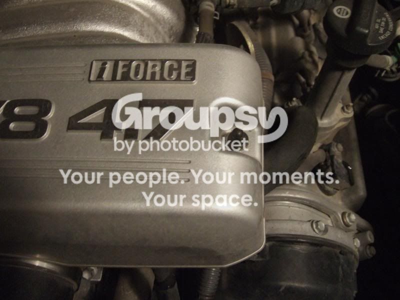

ok i will give you great write-up on tools and process it will take to clean your throttle body on a 4th Gen 4Runner i am using a 2003 V8 with a K&N CAI.....

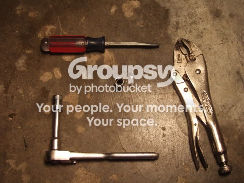

the basic tools are:
Flathead screwdriver, socket wrench with a 3-inch extension, and a 10mm socket and a 12mm socket, also some pliers or vice grips.
DSCF6442.jpg~original
DSCF6424.jpg~original

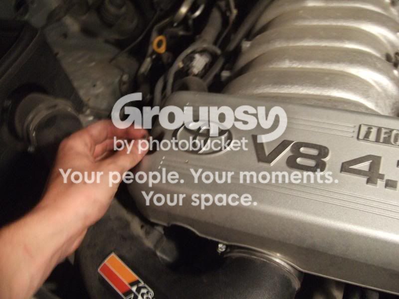

steps:
1. using the 10mm socket remove the TWO black nuts holding the cover on. then remove the cover and screw nuts back on so not to loose them.

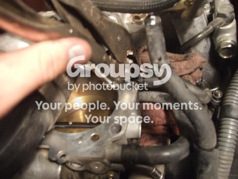

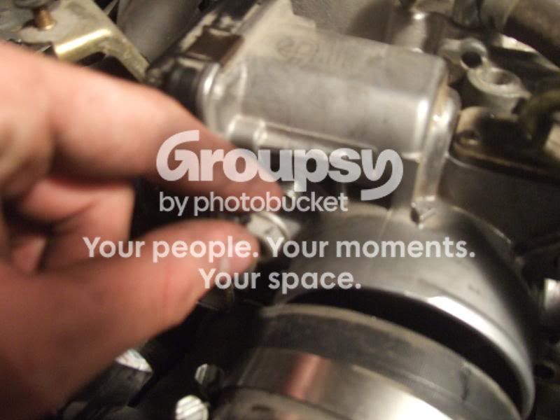

2. remove the throttle control sensor clip.

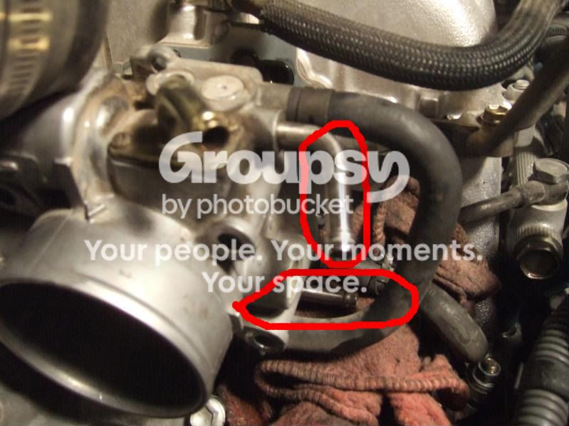

3. now using your 12mm socket remove the 2 nuts and 2 bolts, (the nuts are on top and bolts are on bottom. also may have to remove intake tube to get to a bolt) thats where my flathead came in handy.
DSCF6439.jpg~original
DSCF6437.jpg~original

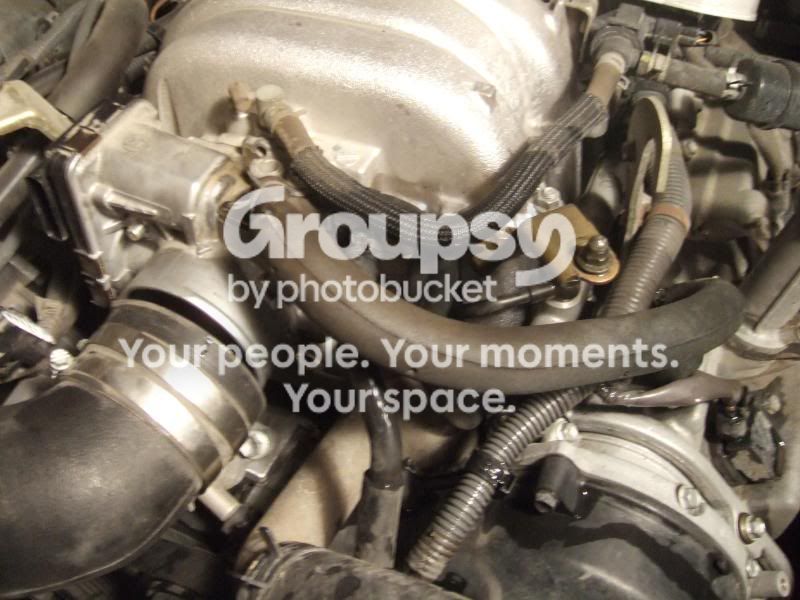

4. using your vice grips pull back a few of your ring clamps that you can get to (but do not pull the hoses off) .
