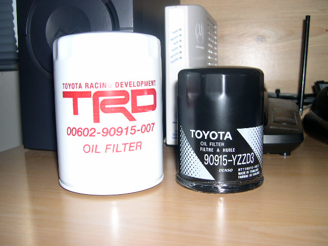

TRD OIl Filter (HUGE)!
I call the Toyota dealer where I get these TRD filter from and they said that it will fit both 2003-04 V8 and V6 motor . so I order 3 of them. So I got them today and when i went to open the box OMG! the TRD filter is like twice the size of the stock filter? Is this the right filter for my car?? I mean this thing is HUGE!:bugeye:

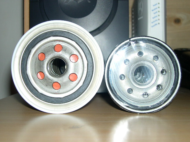

pix 2

I'm sure you could call TRD to double check. The gaskets do seem to line up properly, although it's hard to tell from the picture you gave (second one).
I don't think I've ever seen an oversized filter like that. I mean, I've seen them be 'taller' from one filter to the next, but never wider. I guess I always figured the gasket and inlets would not match up correctly but looks like they might have solved that.
I'd really love you if you cut one open so we can see if it's the same synthetic organic media used in the stock filter. If so, then I'd say you have a winner. If not, then I'm not sure if the TRD filter is better, even if it is bigger. It may just flow better, which isn't always a good thing.

I do not think that will fit the V8. The stock just bearly fits. It's the OD that I am concerned about. What do they cost?

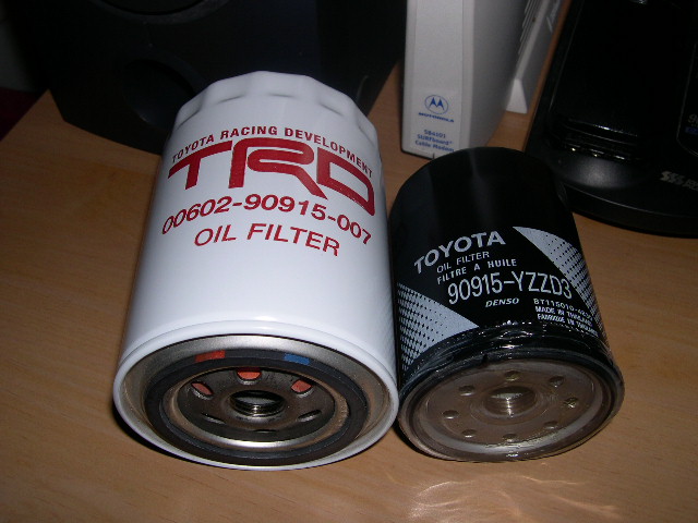

I would love to cut one apart but all i have is a heck saw? they cose $8 ship for 0ne. the bottom rubber is about 1 to 2 mm larger then the stock also the little hole around the bottom are larger then the one on the stock filter. that all i can tell from the outside. This is waht I got ouff TRD website.......

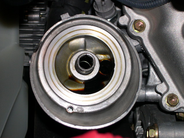

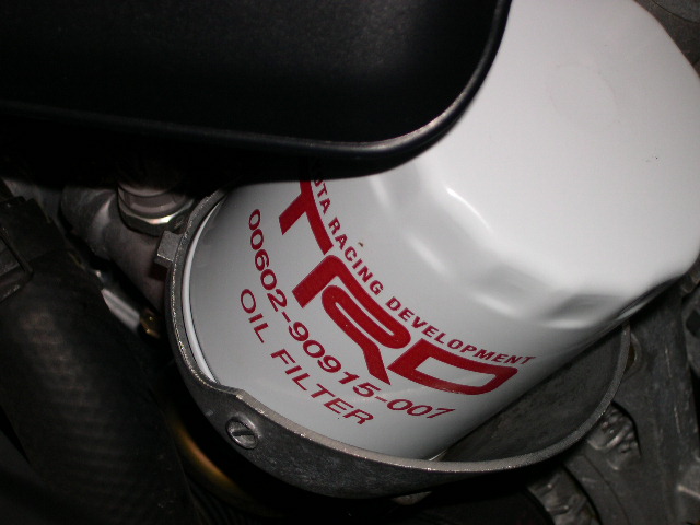

I have not try it yet. waiting for my next oil change about 3k to go. but just by eye balling it i said it should fit with about 2 mm left around the oil filter tray thing on the V6. it pronely going to be a perfect fit but not tight. also the gasket is pretty wider then the one on the stock filter as you can see in the picture.

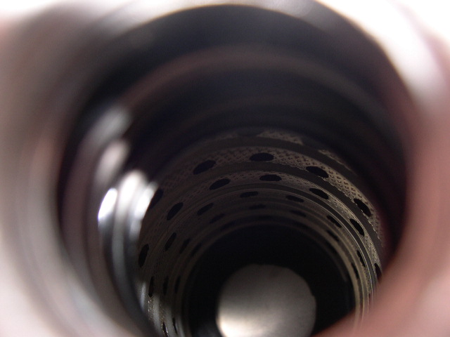

Here is a better picture of the bottom and inside the TRD filter. LOOK like better filter construction inside the TRD then the stock.

PIX 2 inside of TRD filter.

That filter is made by Wix/Napa.

I have a couple of the big TRD oil filters, and they do not fit under my sport edition. The anti-roll bar gets in the way of starting the threads. I am unwilling to remove the bar to install the filter.
